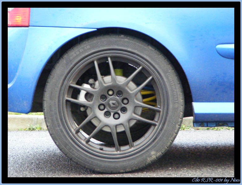

-Na Clia RS pa paše direkt določene čeljust od Scenica 2 in diski velikosti 300mm. Sam sem jo dobil od 1.9 dCI letnika 2004. Pazite, da vam na odpadu ali kjerkoli boste že nabavljali ne poturijo navadnih od ostali Scenicov saj imajo nekateri diske velikosti 280mm ali pa diske na 5 vijakov! Tudi prodajalcem, ko kupujete diske in ploščice 3x to omenite ker bodo drugače prinesli ali napačne diske ali pa ploščice (meni so naprimer dali napačne ploščice). Gor pašejo le feltne velikosti 16 col ali več! Na sliki so to leve.

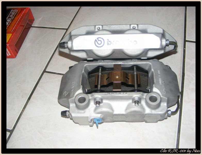

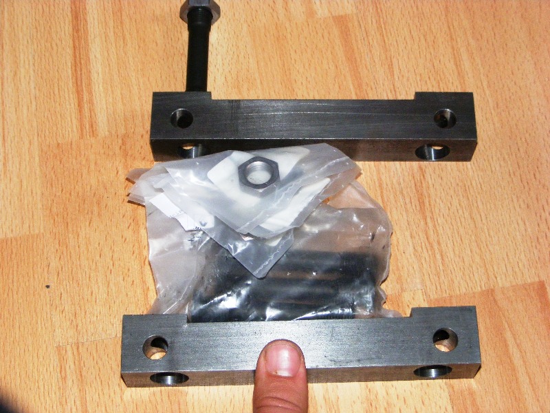

Da se tudi namontirati štiribatne Brembo čeljusti od Megana 2 RS ali Clia 3 RS:
For those wanting to go the way of 4 pot calliper, I'm building up a DIY kitbase on the Megane 225 and the Clio 197 silver Brembo Calliper.
At first I will propose 2 kit for the front (280mm or 300mm disc), but I'm still working on rear kit to match up.
Kit 1 ( OEM 280mm disc) BRAND NEW kit= 660£
As mentioned, this kit retain the original 280mm Disc, it is compatible with ABS/ESP. For more homogeneity i would advise to upgrade the rear end or perform a bias adjustment.
Kit is compose as follow:
- A set of Brembo calliper (Clio R3 197 spec), machined worked to fit.
- A set of Brembo road pads to match.
- Specific caliper mounting brackets (strong HC steel).
- All bolts and nuts to mount the kit.
Kit 2 ( uprated 300mm disc) BRAND NEW kit= 720£
As mentioned, this kit is provided with an uprated 300mm Disc, it is compatible with ABS/ESP. For more homogeneity i would advise to upgrade the rear end or perform a bias adjustment.
- A set of Brembo calliper (Clio 197/ MRS R26 ).
- Brembo or equivalent plain 300mm disc to match.
Option:
- Upgrade to EBC blue stuff + 128 Pound
- Upgrade to EBC Yellow stuff + 133 Pound
- Braided goodridge brake hose + 50 Pound (as spesific hose do not exist for this kit I'll provide Clio 197 hoses which are compatible)

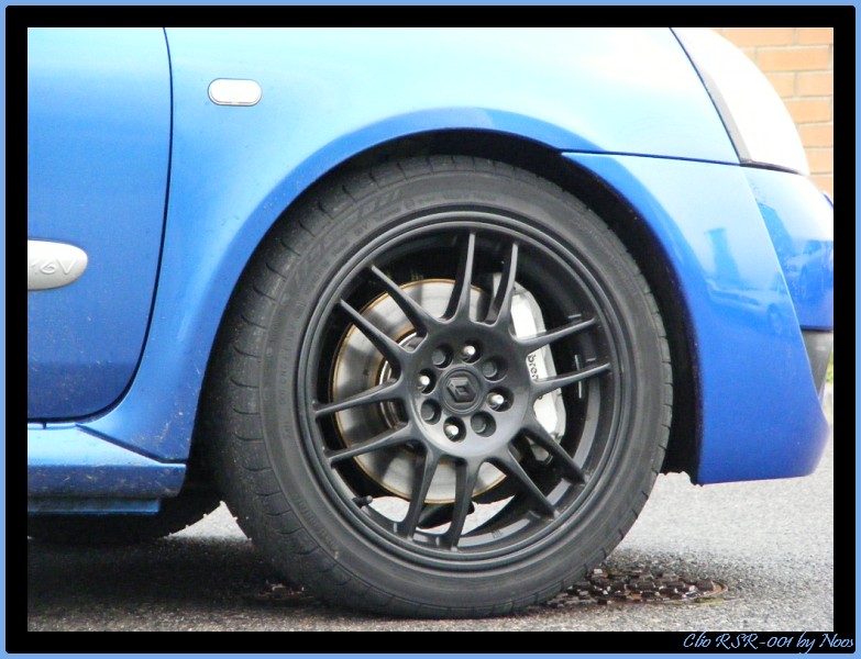

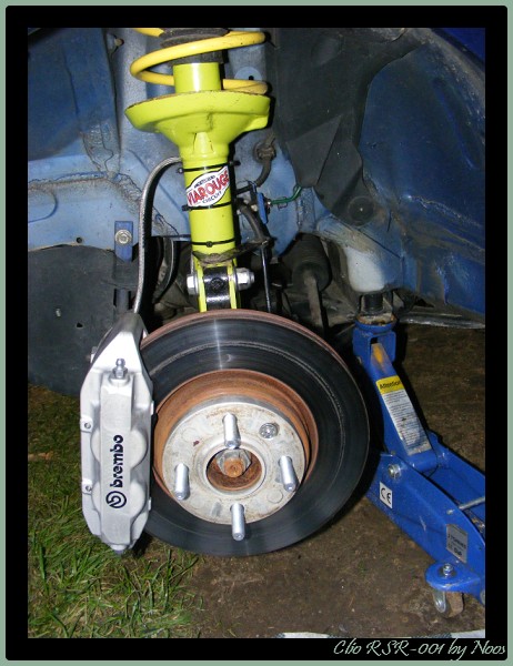

Opombe: Pod 280mm pašejo le določene 15 colske feltne, pod 300mm pa paše večina 16 colskih felten.I'm running Megane R26 Brembos on clio original size Brembo HC disk with blue stuff pas all around... I have the same or very similar breaking power that Carbone Lorraine RC6/RC8 pad with Brembo MAX grooved disk...
The only thing: I'm using the same disk since over a year, blue stuff pad last about 3/4 track days ( approximately 1000 kilometer of track use), due to bigger size pad, better pressure distribution, better heat dissipation (thank to the alloy calliper); my breaking system is a lot less stressed, less hot, and show itself to be reliable at the extreme for an hypothetical never-ending track session... I beat or compete with super-car in term of breaking performance. Breaking noise and dust are limited to a minimum considering pads. in up-keeping, a Set of 39 pound Brembo HC every year and half and set of blues stuff every 5 to 6 month depending mainly on how much track day I'm doing.
Comparing with my OEM set up, where breaking system get so hot that valve plug start melting, it growl and make a lot more anoying noise, brake dust destroy completely alloy rims 's painting, heavy use will make you replace your pads every 2 track day( which by the way CL pad are more expensive that Blue stuff) and the same goes for the disk, i use to replace my disk twice a year...
it is self explanatory... on very heavy use, brembo 4 pot kit will be more reliable, less expensive on up-keeping, as it use less pad and less disk, while breaking better and still using cheap middle range pads and disks... but like you said you have to get to buy it. and that original purchase comes with a cost.
Edit: added a pic of my Cup with R26 brake, it is not only performing, it 's also looke Fxxxing good!

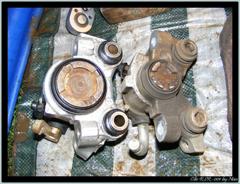

Here comes the bonus ... Rear R26 Big brake set up...(also keeping the original disk size)

Kar nekaj teh kitov prodaja firma http://www.rikusautomotive.com/, predvsem nosilce za Brembo čeljusti, včasih imajo na zalogi zgoraj omenjene čeljusti (dvobatne, zadnje čeljusti...). Samo v vednost.Kit include:
- Plug and play set of caliper and pads Holder in good conditions ....
- Set of pad with about 60 % wear. ( Big specific pads )
- Specific little bits like spring, etc...
75£ including delivery world wide.
option:
- Longer Hand brake cable as OEM one get little too short(H-brake tensioner adjustment under the car will be required) +25£
- Set of new valeo Pads (like in the picture) +40£
- Set of new EBC ultimax Pad : +40£
- Set of new EBC Green stuff: + 67£

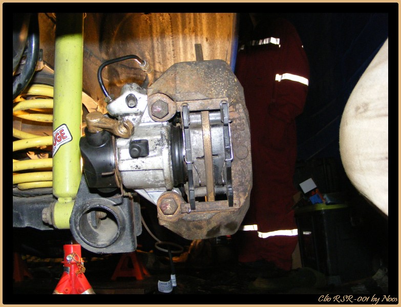

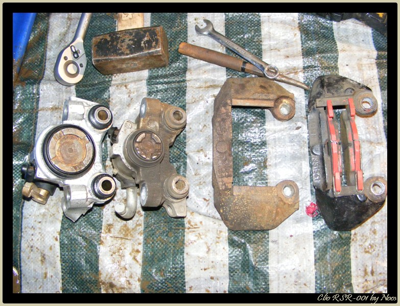

Photos: comparison between OEM caliper and my kit:
then fitted:
only one kit available for now...
Note:
Compatible with ABS.
kit is 100% plug and play except for hand brake cables which get too short, I can provide longer cables (options) but they are little too long and require H-brake tensioner to be adjusted to maximum. at the moment I'm still looking for perfect Cables.
Braking power of those caliper is huge and Bias adjustement or pad quality balancing is required. a set up of RC6/RC8 in the front and OEM or green stuff at the rear would not be too bad....
Kit retain all OEM mounting bolts.
15 inch or more rims will fit without spacer as long as offset is kept to ET 40 when pads are new.
